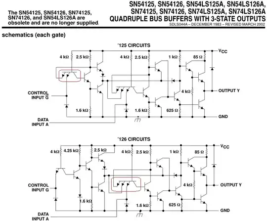

Multi emitter bjt's are usually used to close some sort of feedback from following stages, maybe avoiding the bjt to saturate, or in logic input stages where the logic funcion is implemented directly by the wired AND, such as in this TTL AND input stage:

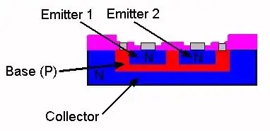

At solid state level to add an emitter you simply add an emitter diffusion:
multi emitter
For a multi collector you just need more than one collector contacts.
