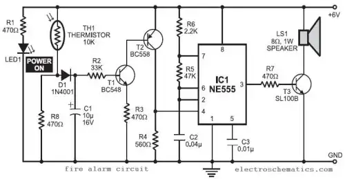

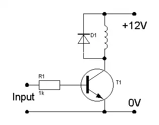

Schematic
A schematic shows connections in a circuit in a way that is clear and standardized. It is a way of communicating to other engineers exactly what components are involved in a circuit as well as how they are connected. A good schematic will show component names and values, and provide labels for sections or components to help communicate the intended purpose. Note how connections on wires (or "nets") are shown using dots and non-connections are shown without a dot.
Schematic

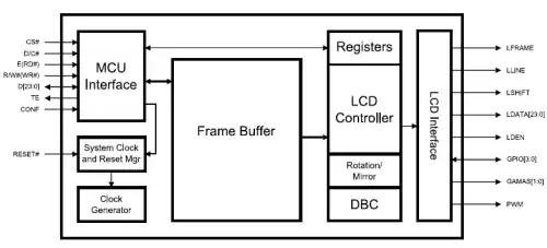

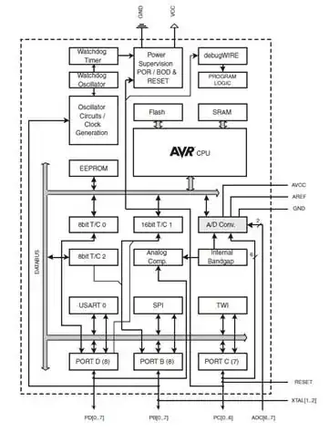

Block Diagram
A block diagram shows a higher level (or organizational layout) of functional units in a circuit (or a device, machine, or collection of these). It is meant to show data flow or organization between separate units of function. A block diagram gives you an overview of the interconnected nature of circuit assemblies or components.
Block Diagram

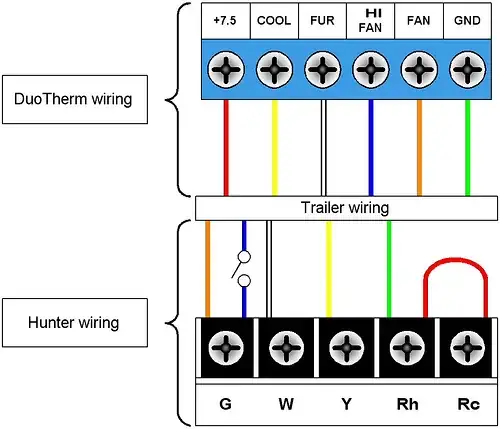

Wiring Diagram
A wiring diagram is sometimes helpful to illustrate how a schematic can be realized in a prototype or production environment. A proper wiring diagram will be labeled and show connections in a way that prevents confusion about how connections are made. Typically they are designed for end-users or installers. They focus on connections rather than components.
Wiring Diagram

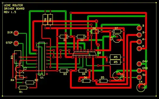

PCB Layout
A PCB Layout is the resulting design from taking a schematic with specific components and determining how they will physically be laid out on a printed circuit board. To produce a PCB Layout, you must know the connections of components, component sizes (footprints), and a myriad of other properties (such as current, frequencies, emissions, reflections, high voltage gaps, safety considerations, manufacturing tolerances, etc.).
PCB Layout

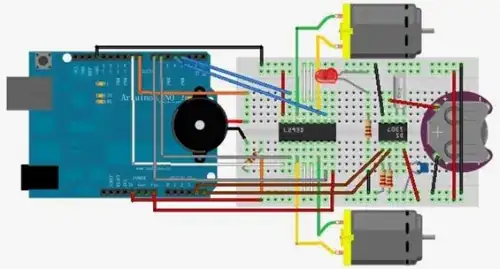

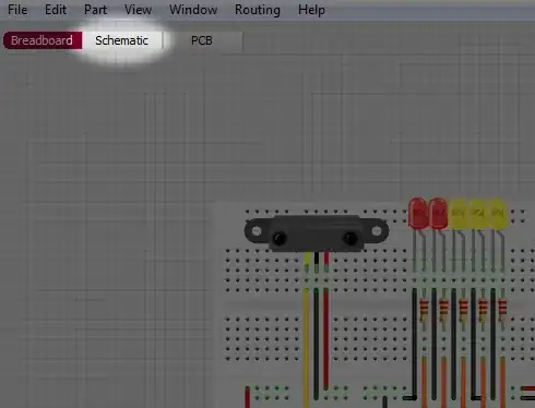

Fritzing
Fritzing is a popular open-source software program designed to help you create electronics prototypes. It uses a visual approach to allow you to connect components to Arduino using a virtual breadboard, and even provides ways to design a PCB. Its strength is in the ease with which new users can approach it. One of the principal working views is the virtual breadboard:
Fritzing diagram
However, as you can see, it can be time-consuming to tell exactly how components are connected, even if you are very familiar with how breadboard connections work (as most electronics engineers are). As a circuit gets more complex, the visualization becomes more cluttered.
Fritzing provides a way to produce a schematic:
Fritzing screenshot
Be sure to use this to produce a schematic if you need to ask questions about your circuit. It will help others to quickly understand the components and connections involved in your design.

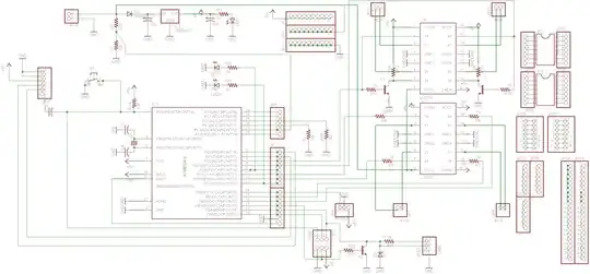

  • You choose simple a schematic, block diagram, wiring diagram and pcb layout, but choose a fritzing diagram that's ten times more complex... – Passerby Apr 03 '14 at 04:50
  • @Passerby The point was to illustrate how they can become difficult to decipher; a simple Fritzing would not have shown that. – JYelton Apr 03 '14 at 04:52
  • @JYelton I think the point was bias against fritzing diagrams. Otherwise each of the diagrams would have equal complexity. It's not like schematics, pcb layouts, and block diagrams can't be equally as difficult to decipher. It's just plain bias against it. Why not get quad motor driver + rtc + microcontroller diagrams for each of the other types, to compare them **properly and without bias** – Passerby Apr 03 '14 at 04:58
    @Passerby It's not exactly easy to find equal versions using free images. I obtained Fritzing with the idea of creating my own images instead of looking for others, but I didn't have time to really get into it. I admit bias because I *prefer* schematics for communicating circuit designs. (I think many other members of the community would agree.) Feel free to supply your own answer with bias-free diagrams. – JYelton Apr 03 '14 at 05:07
  • I think one of the purposes of the breadboard view in Fritzing is for 'schematic capture': if you have already developed a circuit on breadboard you can reproduce that in Fritzing and it will then generate the schematic for you. Fritzing is great for PCB's, I've had a couple of boards fabricated from Fritzing designs with no trouble. And it doesn't have to involve Arduino! Also the breadboard view can also be used to plan circuit layouts on stripboard. – nekomatic Apr 03 '14 at 08:28
    @Passerby: The schematics for the system in that block diagram would take many pages (but still be usable), and a "wiring diagram" for the system would be an impenetrable rats' nest. That's not a skew aimed against Fritzing diagrams, it's reality. – Ben Voigt Apr 03 '14 at 21:24

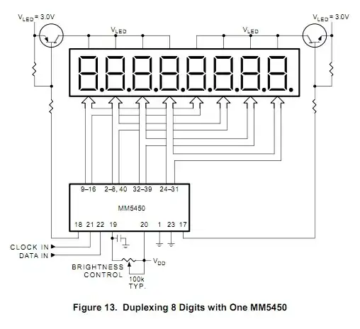

Compare Apples to Apples. Every Type of Diagram Is harder to read the more complex it becomes, not just fritzing
Comparable Schematic:
Comparable Wiring Diagrams:
Comparable Block Diagram:
Comparable PCB Layouts:
Passerby
  • 72,580
  • 90
  • 202
    Actually, JYelton's images were more consistent in circuit complexity that yours are. His had about the same number and size of ICs and many fewer discretes on the wiring diagram. While yours are the same visual complexity as each other, but the block diagram has much MUCH more complexity, and the schematic has a lot more circuitry documented than the remaining ones. Which is pretty much the point. – Ben Voigt Apr 03 '14 at 21:22
  • @BenVoigt because a single ic schematic or straight wiring is consistent with an arduino + quad motor driver + motors + rtc + battery backup + buzzer? – Passerby Apr 03 '14 at 22:46
  • Guess I was thinking of the connection to the Arduino as a connector, and not the entire Arduino. (The Fritzing diagram doesn't show the topology of the Arduino either). Actually it probably should be equated to four distinct connectors on the schematic... since the Fritzing diagram does distinguish four connectors. So that would add a little to the schematic complexity. Still quite close. A schematic would represent connections to motors and buzzers as two pin connectors, for which the two-pad discretes are a good standin. – Ben Voigt Apr 03 '14 at 22:54
