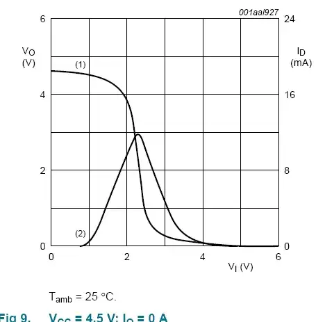

If the NAND gate is made in the obvious way (three parallel transistors to GND and three series transistors to Vdd) then it will have low source capability, the transitions will not be sharp, and the delay time will be load capacitance dependent. Adding a buffer (or two to restore the logic) cleans up all those problems.
Here is what a typical unbuffered inverter (schematic like this)...
..transfer function (output vs. input shown on line (1)) looks like:
With a buffer, the line (1) will be much closer to a square shape. (the second line is the current that is drawn).
