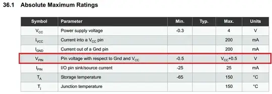

Looking through the datasheet, I'm not really much enlightened:
The ADC IO lines are "Pin"s, so I would assume that exceeding the reference, as long as the voltage is kept < \$V_{CC}\$, while the conversion results may be invalid, it won't cause actual damage to the MCU.

  • I couldn't find information about the internal pin protection in the family reference manual, but I did find [this thread](http://www.avrfreaks.net/index.php?name=PNphpBB2&file=printview&t=84840) which suggests that all GPIO pins have the usual clamping diode arrangement. I guess your second highlight from table 36-7 is pointing out the ADC can't read over the Vref. – David Apr 01 '14 at 06:37
Don't exceed absolute maximum ratings (in fact stay within them as much as you reasonably can). Exceeding Vref isn't a problem providing you don't exceed absolute max ratings. One table is the "don't ever do" table and the other is "don't expect it to function if you do" table.

  • My issue is I haven't *found* an "absolute maximum" for the **ADCs** anywhere, and I don't want to assume this is just a plain-old SAR ADC without Atmel at least stating as much *somewhere*. – Connor Wolf Apr 01 '14 at 07:57
  • Surely Vpin is the AMR? – Andy aka Apr 01 '14 at 07:58
  • I'd *think* so, but the Vref AMR is Vpin - 0.6V, so.... maybe? – Connor Wolf Apr 01 '14 at 08:10
  • I believe that's an operational rating not an absolute rating. – Andy aka Apr 01 '14 at 08:14
  • I don't disagree with anything you're saying, my issue is I can't find anything specific in any of atmel's documentation to confirm it. My gut feeling is that it's probably fine as well, but I don't like to rely on just that. – Connor Wolf Apr 01 '14 at 08:37
  • Basically, I *strongly* **suspect** that just assuming the Vpin - 0.6V value is just a functional rating, and the AMR for the pin is the same as for any other IO pin, but I don't want to design a whole system based on that assumption. – Connor Wolf Apr 01 '14 at 08:38
