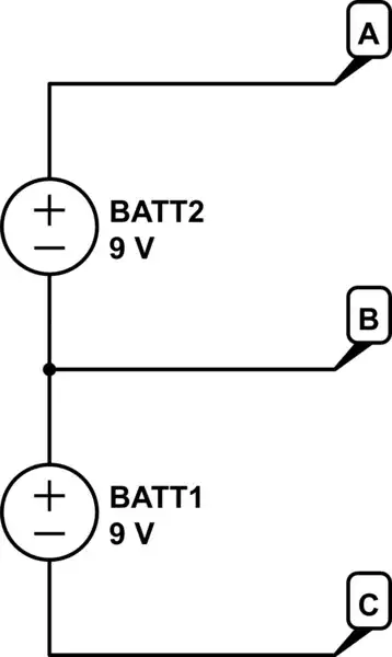

You seem to be confusing (as I did) ground with protective earth. "Ground" is the reference point for the voltage potentials in the circuit, is designated 0V, and all other voltages are compared to that. Consider this circuit, where power is provided from two 9V DC batteries in series:
Any of the points A, B, and C may be considered ground but the circuit will be considered to have different voltages depending on which point is selected. If point A is ground, B is -9V, and C is -18V; if B is ground, A is 9V, and B is -9V; if C is ground, A is 18V, and B is 9V.

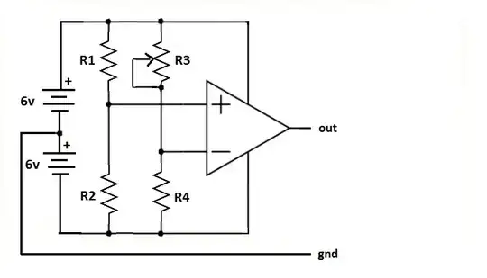

Here there are two batteries, so you have both a +6v supply and a -6v supply, relative to the ground lead between them. The reason for the two supplies is the comparator, which needs both positive and negative supply voltages. This means the output of the comparator will also swing both positive and negative. Op-amps are another type of IC that sometimes require both positive and negative supplies. However it is more common for both op-amps and comparators these days to require only a positive supply.

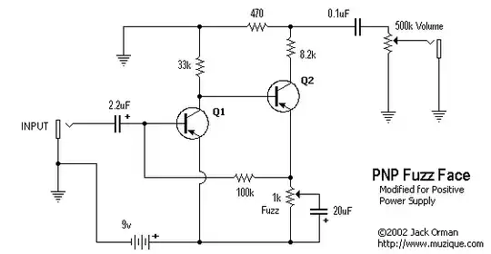

    It's not really true that "Traditionally, "ground" is the lowest potential in a circuit". In fact when PNP transistors were preferred Ground was traditionally on the +Ve battery terminal and the Supply was -Ve. See http://www.muzique.com/lab/fuzzface.htm for context. – akellyirl Mar 26 '14 at 09:53

Historically Germanium Transistors were mostly available as PNP devices. In these circuits a Negative supply was the norm with Ground being chosen as the +Ve potential.
The circuit below is from a classic Guitar effect unit (source)
Notice the +Ve of the battery is labelled as Ground and the power is Negative.

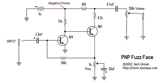

But this ground scheme may be incompatible with other Guitar Effect units....
So it can be redrawn:
