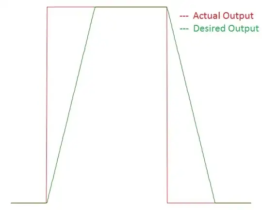

I have an NMOS that is switching too fast for my application. Into the gate I am sending a logic-level square wave (PWM). Unfortunately for me, as expected, the output is also a near square wave.
How can I get the Vout to be more trapezoidal? Or said another way, what is the simplest modification I can make to decrease the slew rate at the output?
Note: (Vin) is the voltage applied at the gate of the NMOS & (Vout) is the voltage seen at the drain of the NMOS.

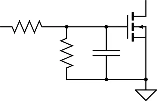

The only control you have over the resistance of the FET is the gate-source voltage. You need to slow down the change of that voltage. The most common way of doing that is an RC filter at the gate. Put a resistor between your drive source and the device gate, and the gate's parasitic capacitance will form an RC filter. The bigger the resistor, the slower the turn-on and turn-off.
If the resistor gets too big, you can have noise immunity issues (false gate triggers and such), so past a certain resistor value (maybe in the 10k-100k range) you're better off adding capacitance gate-source to slow the switching down further.
As a general rule, I always put an RC filter with a pulldown resistor on all FETs. This allows control of the rise-time, and provides improved noise immunity.
Keep in mind that any time your FET spends not fully "on" or "off", it sees increased losses. If it's on, the device has very low voltage across it. If it's off, the device has no current through it. Either way, low loss. But if you're in between, the device sees both voltage and current, meaning its power dissipation is far greater during that period. The slower you switch, the greater that loss becomes. At what point it becomes a problem depends on the FET, the source, and the switching frequency.

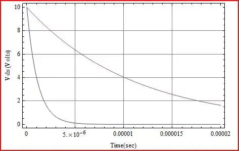

Not enough Miller time? Just extend it.
Spehro has the right approach here. I am going to ride his coat tails and expand on the idea a little, because it is such a good idea for this kind of thing.
\$C_{\text{dg}}\$ is special in a FET because it provides negative feedback to the gate. Part of what that means is that it also gets multiplied by the transconductance (\$g_{\text{fs}}\$) of the FET. So, it has a larger effect than it's size would lead you to believe. But, let's forget about \$C_{\text{dg}}\$ for now and instead add an external capacitor from drain to gate (\$C_{\text{fb}}\$), because if you really want to slow down the rise and fall times of the FET that's what you'll do. Here is a schematic to help illustrate:
As \$V_{\text{drv}}\$ rises and \$V_{\text{ds}}\$ falls you can probably see how \$R_g\$, \$R_L\$, \$g_{\text{fs}}\$, and \$C_{\text{fb}}\$ all play a part in limiting the value of \$V_{\text{gs}}\$. Small signal transfer function of \$V_{\text{ds}}\$ relative to \$V_{\text{drv}}\$ is:
\$-\frac{R_L}{s C_{\text{fb}} \left(g_{\text{fs}} R_g R_L+R_g+R_L\right)+1}\$
And, \$R_g\$, \$R_L\$, \$g_{\text{fs}}\$, and \$C_{\text{fb}}\$ are all involved in forming the pole. (Note, all the FET capacitances are left out here for clarity.)
To show approximately how this works out, put in some values into a very simplified model. \$R_g\$ = 1000 Ohms, \$R_L\$ = 2 Ohms, \$V_{\text{drv-pk}}\$ = 5V, \$V_{\text{cc}}\$ = 10V, \$g_{\text{fs}}\$ = 5 S.
Here is a plot of \$V_{\text{ds}}\$ on application of \$V_{\text{drv-pk}}\$.
The blue curve is \$C_{\text{fb}}\$ = 100pF, and the purple curve is \$C_{\text{fb}}\$ = 1000pF. Of course, switching loss will be huge and huger. It should also be mentioned that adding a Miller feedback capacitor like this will make the circuit more sensitive to dV/dt turn on.
gsills
  • 7,133
  • but if I introduce a dV/dt (pretty much a voltage spike) at Vgs, it will turn on only momentarily right? – hassan789 Mar 21 '14 at 13:28
  • @hassan789 Well, dV/dt events are momentary one way or the other. It's charge injection from the drain to the gate through Cfb, and depends on Vcc and the true nature of the load. If Vcc appears quickly and the load has a capacitive element dV/dt might be enough to cause some conduction. A rough estimate could be made of tolerable dV/dt with dV/dt~Vth/(RgCfb). Or dV/dt might extend turn off beyond expected. Just need to be aware. – gsills Mar 21 '14 at 16:18
