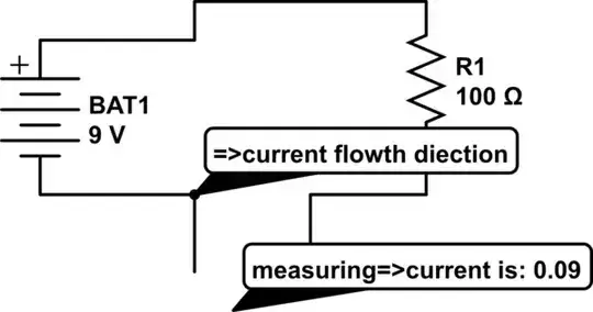

In the circuit shown if current is flowing from negative side of battery to positive side how multimeter can know the existence of resistor before electrons in wire hits the resistor?
I mean how multimeter measures current before it reaches the resistor? How it knows that a resistor exists?

The meter is only measuring the amount of charge per unit time that is passing through its internal shunt resistance. It doesn't know or care that there is a resistor in the way.
Your resistor is just limiting the current (charge/second) that the voltage source can "push" through the meter. Think of a water meter measuring water flow. If you put a kink in the hose upstream, the water flow slows down and the meter measures less flow.
