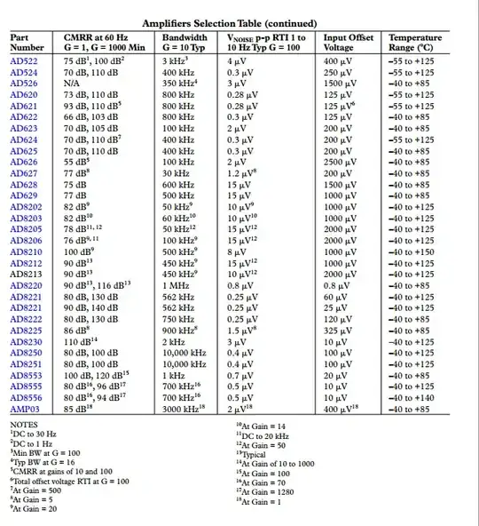

For example, here is a page from the aforementioned AD guide.
The selection is huge. How do I know what CMRR is good enough? 70dB? 80? 90? Or the input offset? 1mV? 500uV? 50uV? This is a major confusion of mine and hints at my lack of experience with practical design.

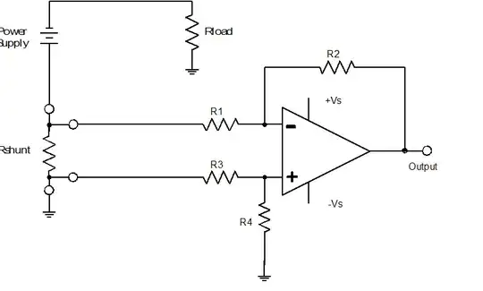

There's a good overview here (Word Doc). Note the examples that use a regular op-amp.

Input Offset Voltage: The amplifier acts as if there was a battery with a random value up to this voltage connected in series with one of the input pins. Since your maximum current will produce about 50mV, an input offset of 1mV will create a 2% of full scale bias in your measurement. So, with no current through the shunt, it may measure anywhere between about -5 and +5 amps. The offset is fairly constant for a given unit at a given temperature, so you could measure with no current and compensate.
CMRR: A common mode voltage (present at both input terminals) will appear attenuated relative to the differential signal at the output of the amplifier. For example, if your CMRR was 80dB, and you placed the shunt at the positive terminal of the 12V battery, with your measurement circuit's ground at the negative terminal, the common mode voltage will be close to 12V. That will appear on the output as a \$12*10^{-80/20} = 1.2\$mV input error, once again fairly significant in your circuit. Reducing the common mode voltage will reduce the required CMRR, but keep in mind that many noise sources will also show up as a common mode voltage.
Ultimately, it comes down to keeping the total error for the measurement within limits. CMRR, input offset voltage, noise, resistor tolerances, the resolution of any ADC, and so on all contribute to the total error. It can be helpful to create a spreadsheet to calculate the contribution of each source of error to the total. If some parameter is only contributing a small fraction of your total error, it doesn't make sense to spend a lot of money to improve it.
