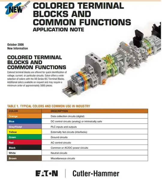

Try this chart for size: -
Phoenix contacts also use the same code except the green/yellow combo is used in the UK (and EU) as ground and GRN in the US): -
The colors are following IEC standards for single phase AC wiring. Green/yellow (green with a yellow stripe) for protective ground, blue for neutral and brown or black (the unmarked grey terminal) for hot. The grey terminal is left unmarked not only due to the ambiguity in the IEC standard, but so the installer may mark it themselves. Individual segments of terminal strips can be ganged together with jumpers or left independent. However, all AC ground and neutral wires are typically connected together (the exception being transformer-isolated circuits). That leaves the hot wire to function as the on/off signal of a control system. In a system with many independently controlled devices, that means many hot wires and a necessity for color labeling beyond simple black or brown.
