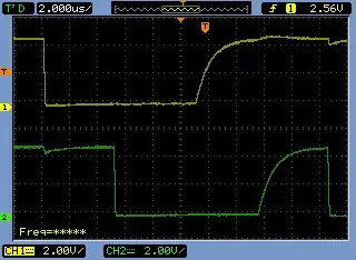

In a digital wall clock I designed (using the DS1307 RTC and the ATmega328 MCU), I accidentally omitted the pull-up resistors that must be wired to both I2C lines. In the end I was lucky enough that the internal pull-ups on the ATmega I2C lines were enough to (barely) allow the communication between the devices. The result were long rise times on the I2C lines and speed reduction to 32kHz as seen in the scope shots below.
Edit: Actually, the frequency is exactly 100kHz - there are 2 peaks per 20us on the green trace. I initially thought there was a reduction to 32kHz because my scope calculated the frequency on the yellow trace.
Scope shot 1 Scope shot 2
What's puzzling me now is how the devices decided that 32kHz was enough for the communication to take place. The DS1307 datasheet says that the device supports 100kHz frequency on the I2C bus. How come it ended up using 32kHz instead? Is there some kind of handshake phase where the frequency is stablished?

    In your system the DS1307 is a slave and it's SCL line is an input only. The frequency is set by the master the MCU. Whoever wrote the firmware for it decided what speed they wanted. There is no negotiation its hard coded. – Warren Hill Mar 13 '14 at 14:04

  • Actually, the frequency has always been exactly 100kHz - there are 2 peaks per 20us on the green trace. I initially thought there was a reduction to 32kHz because my scope calculated the frequency on the yellow trace. This makes your answer correct. Thanks!! – Ricardo Oct 12 '14 at 01:05

The RTC library you use doesn't change TWBR. Something else you are using might have changed it. Or the long slow pull-up time from the super weak internal pull-ups have effectively caused the ATMega's i2c engine to slow down. The engine does check to see if the line is high or low before changing it.
That said, i2c clock frequency is arbitrary, up to the lowest maximum supported frequency of any device on the the bus (and maybe a few tens of Hz more). Any faster and you start getting read and write issues. Some devices have minimum frequencies before they time out, but I've seen 400khz devices work at 10khz. The clock speed is solely decided by the master (i.e. you, the coder).
There is an option for clock stretching on the slave's part (it holds the clock line low until it's ready, and the i2c spec requires that the master check for this), but the scope pictures don't seem to indicate that this is happening here.
If you were to add some proper external pullups, without changing any code, you should see the frequency increase closer to 100kHz as the Wire Library defines as standard
