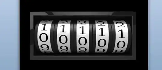

The two's complement system is in use, because it stems from how simple hardware naturally operates. Think for example you car's odometer, which you have resetted to zero. Then put the gear on reverse, and drive backwards for 1 mile (Please don't do this in reality). Your odometer (if it's mechanical) will roll from 0000 to 9999. The two's complement system behaves similarly.
Please note that I'm not really offering any new information here, just the odometer example which someone might find helpful - it helped me to understand the rationale of two's complement system when I was young. After that, it was easy for me to intuitively accept that adders, subtractors etc work well with the two's complement system.
And yes, my Nissan's odometer does work this way.

  • Your answer is about overflow (and underflow), but since the odometer doesn't display negative numbers, it doesn't address anything two's complement-related... – marcelm Sep 26 '17 at 10:48
  • @marcelm, Actually, the odometer example _does_ explain twos complement. It's just that PkP did not go far enough with the explanation. If a six-digit odometer reads zero, and you drive in reverse for one mile, then you would expect it to read -1. Instead, it reads 999999. That's because 999999 is the six-digit, tens complement representation of -1. – Solomon Slow Sep 26 '17 at 12:21
  • @jameslarge No, it still doesn't. There is nothing in the answer that actually touches two's complement. Or one's complement, or sign-magnitude, or any signed number representation. – marcelm Sep 26 '17 at 14:09
  • @marcelm Yes there is: the very core idea of the two's complement system: that zero minus one equals the maximum representable unsigned integer. That's the idea of two's complement system. No other signed number representation offers this (to my knowledge). And the odometer example shows how naturallly this behavioral property comes from the simplicity of engineering; in the case of the odometer: from mechanical engineering. In both mechanical and electronic world, it (the two's complement system) is the simplest way to make it work. – PkP Oct 01 '17 at 09:14
