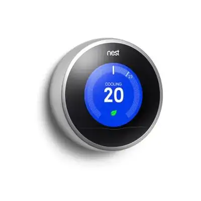

I note that the Nest thermostat (where they did have plenty of money to spend) appears to be a masked square LCD with a bezel and crystal that give the illusion of a round LCD display.

    @ChrisLaplante It *is* a square LCD, I believe. – Spehro Pefhany Mar 12 '14 at 02:07
    The Nest thermostat uses square glass, but the actual LCD elements are deposited in just the round visible area. See the [iFixit teardown](http://www.ifixit.com/Teardown/Nest+Learning+Thermostat+2nd+Generation+Teardown/13818) (Step 12 is the one relating to the LCD). – Connor Wolf Mar 12 '14 at 08:15
    Or look at this closeup image of the LCD [here](http://d3nevzfk7ii3be.cloudfront.net/igi/oYnUQSyTWUSvrFXW.huge). – Connor Wolf Mar 12 '14 at 08:16

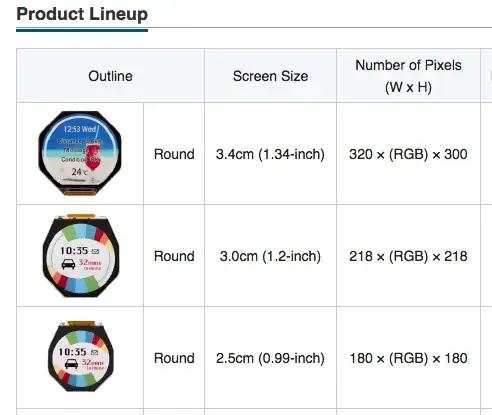

There are lots of these available from Japan Display, that is the source of supply for the pebble watch/wearable.
Here is a snip from their product line (from website) up as of July 30,2016:
As you can see in some places the Glass is octagonal, but the 3.0 cm diameter outline is a distorted octagon.
The actual active imaging area is roughly circular.

  • It's good to add updates to a question like this. A search for "Sharp's free-form display LCD panel" shows they'll be happy to saw if we're willing to pay. – uhoh Sep 24 '16 at 06:36
