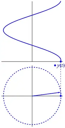

FFTs work by treating signals as 2-dimensional -- with real and imaginary parts. Remember the unit circle? Positive frequencies are when the phasor spins counter-clockwise, and negative frequencies are when the phasor spins clockwise.
If you throw away the imaginary part of the signal, the distinction between positive and negative frequencies will be lost.
For example (source):
Phasor spinning
If you were to plot the imaginary part of the signal, you would get another sinusoid, phase shifted with regards to the real part. Notice how if the phasor were spinning the other way, the top signal would be exactly the same but the phase relationship of the imaginary part to the real part would be different. By throwing away the imaginary part of the signal you have no way of knowing if a frequency is positive or negative.

    Very good illustration. I think worth underscoring that if you only think of frequencies as sinusoidal waves, then you can't have negative frequencies, because if you spin the other way, the top half of the illustration looks the same. This is also why when you do a FFT of real signals (by arbitrarily setting the complex part to 0), the negative frequencies in the result are a mirror of the positive frequencies. – Phil Frost Mar 11 '14 at 12:58
