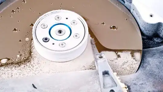

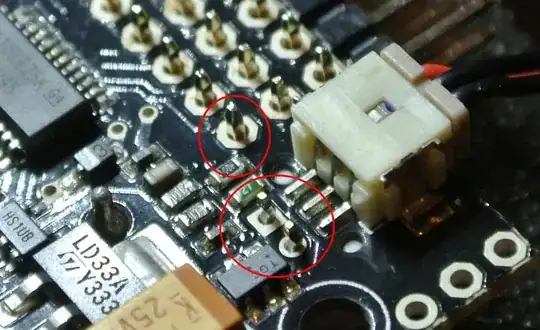

Now the big problem is the cold. Most consumer made devices are not ready for low temperatures. LCDs contain crystals in them that could freeze and damage the components. The lubricant in the bearings for hard drives will thicken, slowing it down to the point that the device can't boot. Condensation could also be an issue as water droplets may form inside the unit and short something out. The thermal strain can also damage the board, solder joints or components. As the device cools and shrinks it the internal pressures on the parts could damage them if it was not designed for those conditions. In general the 0 - 45 C rating is not something the marketing department made up.
Hard Drive that suffered from cold damage:
Dead Harddrive
Source: http://vortex.accuweather.com/adc2004/pub/includes/columns/newsstory/2013/650x366_11062011_122191277.jpg
A BGA package that had a ball break after temperature cycling
Source: http://electronicdesign.com/boards/pcb-design-and-its-impact-device-reliability
