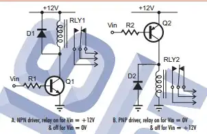

Read this info sheet (http://www1.electusdistribution.com.au/images_uploaded/relaydrv.pdf). and pay attention to these images in particular. They show you what a good switching circuit would be and explain how to implement them.

Is it because the arduino can't supply enough current to trigger the coil in the relay?
Yes. An Arduino (really, a ATMEGA328p or similar) can only provide 20~40mA on a single pin without significant voltage droop and possibly frying the pin. A relay coil can take significantly more. And the Arduino pin output is referenced to VIN, or 5v on a typical arduino. The relay requires 12v, which a transistor can switch.
To choose a transistor, you need to know the Relay's activation current. This can be found on the datasheet for the relay. Once you know the activation current, you want a transistor that can handle 20% more current (as a safety precaution), and that has a gain (hfe) that can amp a few mA at the base to the current needed at the collector. Aside from the flyback diode, you need a resistor between the Arduino and the transistor base (to protect the Arduino output and the Transistor base input.)

    Datasheet http://www.farnell.com/datasheets/1750340.pdf The coil is ~400Ω, with a 12v voltage, that is i = v / r, so 12 / 400 or 0.03A. So a common 2n2222 or 2n3904 will work. – Passerby Mar 09 '14 at 02:04
