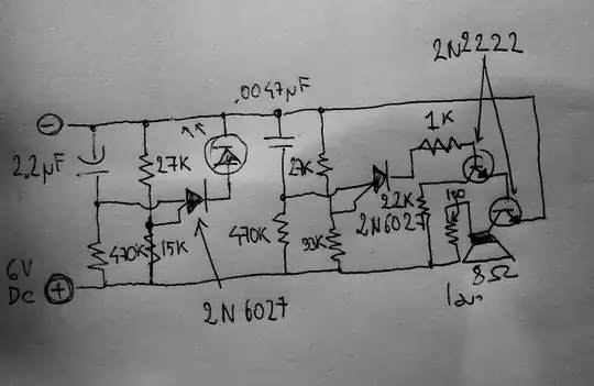

In my case I don't have a 2N2222 transistor. In alltransistors.com I've found that I can use BFX95, BSW63, ECG123A, MM531 that are different alternatives that I don't find in other site where it seems that 2N3904 is the right one. I don't know which are the parameters they look at. For example I'm try to amplify a signal and send it to a loud speaker (with a 100 Ohm resistor) in a circuit with a load lower than 6 V, can I use a C945 that as the same Ueb but uses an hfe of 130 instead of 100 of 2N2222? What will happen?

  • Post the circuit if you want a definitive answer dude - the words that describe it (in your question) are not enough for anyone to be sure of how to choose a different device or, even if the circuit suits the existing device. – Andy aka Mar 06 '14 at 23:49
  • @Andyaka I've tried to drew it with the editor but is to big, tomorrow I will scan it... – G M Mar 06 '14 at 23:51
  • @Andyaka added! – G M Mar 07 '14 at 11:10

If that is a 100 ohm resistor in series with the speaker (not 100% clear in the diagram) and the supply voltage is nominally 6V then the maximum current through the transistor is going to be about 60mA - this could rise to 100mA on a larger supply voltage so be aware of that.
In the circuit you've drawn Hfe variations between one transistor and another won't account for much of a change in performance. I'd expect most NPN transistors to perform equally as good for this design.
