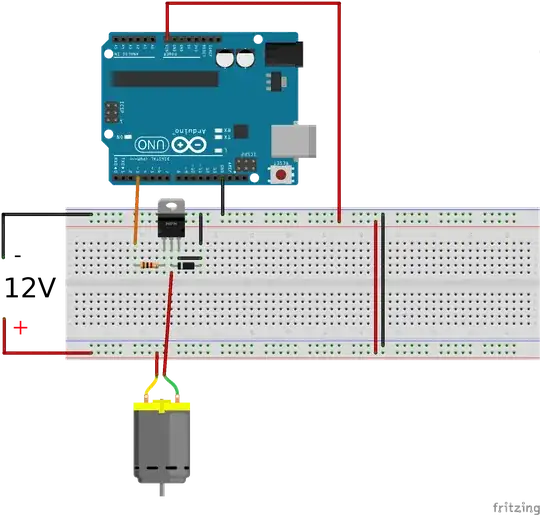

I'm trying to figure out how to control the speed of a 12V DC motor with an arduino and a 12V battery.
I want to split the «power» and «control» parts of the circuit so the Arduino and sensors receive only 5V.
So far, this is what I've tried :
I am able to control the speed of the motor by changing the PWM of pin 3 on the Arduino. This opens the NPN transistor (BUF654).
The problem is that the speed of the motor doesn't change enough.
From 0% to 50% PWM on pin 3, the motor is stalled.
Above 50%, the motor is nearly reaching its maximum speed.
I wonder if I would be able to have a linear variation :
0% - 10% : very slow
10% - 20% : slow
20% - 50% : normal speed
50% - 80% : fast
80% - 100% : RELEASE THE KRAKEN!
Here are the voltage and current the motor draws when using only a battery, or the previous circuit :
| Directly on 12V battery    | 12.7 V  | 61 mA  |
| Arduino circuit (100% PWM) | 12.47 V | 60 mA  |
| Directly on 9V battery     | 9 V     | 54 mA  |
| Arduino circuit (60% PWM)  | 9 V     | 52 mA  |
What have I done wrong? Could the problem come from my motor?

  • Is that diode connected across the transistor? – user28910 Mar 06 '14 at 15:20
  • Yes it is. It prevents damaging the components when the motor stops (current reverses). – mimipc Mar 06 '14 at 15:27

  • Just a friendly reminder. Although your question was well received here, it would have been even better if you had posted a proper schematic diagram of your circuit, instead of a Fritzing wiring diagram. Here are some [Rules and guidelines for drawing good schematics](http://electronics.stackexchange.com/questions/28251/rules-and-guidelines-for-drawing-good-schematics) and [Good tools for drawing schematics](http://electronics.stackexchange.com/questions/1024/good-tools-for-drawing-schematics). – Ricardo Mar 10 '16 at 12:21
Your diode is in the wrong position- it should be across the motor (blocking!) not across the transistor.
The purpose of the diode is to allow current that is flowing in the motor coil to continue to flow in the same direction when the transistor turns off. When the transistor turns off, the voltage at the transistor collector will rise as it was flowing out of the motor. From \$V_{CE(SAT)}\$ it will rise above the power supply voltage and stop only when the transistor breaks down (or when it starts to ring with parasitic capacitance). By putting a diode from the transistor collector to the +12V rail, you prevent the voltage across the transistor from exceeding 12V and and allow the motor current to continue to flow.
The way you have the diode in your pictorial, it would only conduct were the voltage to go below ground. That could only happen if someone mechanically spun the motor very fast in the reverse direction (and your diode would cause the voltage on the 12V rail to increase as a result).

  • I don't see why it should be across the motor, as it is supposed to rotate in both directions (using a DPDT switch AFTER the transistor). Lots of tutorials I've read used the diode acress the transistor to prevent damages to the components. If I missed something, can you explain it please? – mimipc Mar 06 '14 at 15:33
    Okay, it should be across where the motor is NOW. We have no way of knowing what you might have in mind. If you add a DPDT switch it would be across the switch common terminals (or, more simply, from the transistor collector to the +12 rail). – Spehro Pefhany Mar 06 '14 at 15:34
  • I understand your point, but I don't understand why it would change something. The only difference in this case is it prevents current from flowing through the transistor when reversed. If I put the diode across the motor (or the DPDT switch in my case), could that break the transistor if too much current flow back? – mimipc Mar 06 '14 at 15:39
  • Thanks for your edit, it is much clearer now :) I'll give it a try. I think I misunderstood the purpose of this tiny thing. – mimipc Mar 06 '14 at 15:41
    No it will protect the transistor. Current that should be flowing through your motor (creating torque) is being mostly wasted heating the transistor. That's why you're not getting much torque. – Spehro Pefhany Mar 06 '14 at 15:42
Albeit the diode is in an unusual position, the circuit works well. Usually the diode is placed across the inductive load - i.e. across the motor pins - very close to the motor (if you use long wires, this is important). This helps to suppress electric spikes generated by the motor when you stop it but it keeps rotating and acts as a generator for a very short fraction of time.
These spikes can kill your transistor. The other solution - what you have done - is to protect the transistor itself.
You shall note that it is impossible to make a DC motor turn very slowly. This comes from the mechanical structure of the motor. If you're using a motor without gear reduction, you'll see that 30%-100% pwm makes some difference, while 0..30% does nothing. With geared motor (the gears are extra load), you may need go to to 50% just to make it start.

Could it be static friction? What happens if your arduino sketch first starts the motor (maximum PWM) and then slowly decreases over several seconds?
My experience is that it's very hard to run a DC motor slowly (unless you have position feedback of course, or gears).
