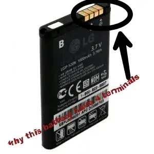

Why do some mobile phone batteries have 4 terminals? I want to use a mobile phone battery for my project.

i think one is for temperature sensing – BASIL VARGHESE Feb 27 '14 at 04:35
The circle in your image covers up the labels for the terminals. Assuming that the missing label is `-`, the other two could be for Temperature, Data, or something else. – jpaugh Dec 03 '16 at 18:49

3I think this is the correct answer - no way to tell for sure. I've looked at various forums online and there is no consensus. Some of them are thermistors, others are ID pins for identifying the type of battery (based on resistance), or I2C (pair of pins), and still others are 1-wire comms. My Samsung battery, for example, is 4-terminal, with 3 of the terminals labeled -, T, and +. The middle is apparently a thermistor, making the fourth a 1-wire bus (to support NFC). – Chris Laplante Feb 27 '14 at 05:10

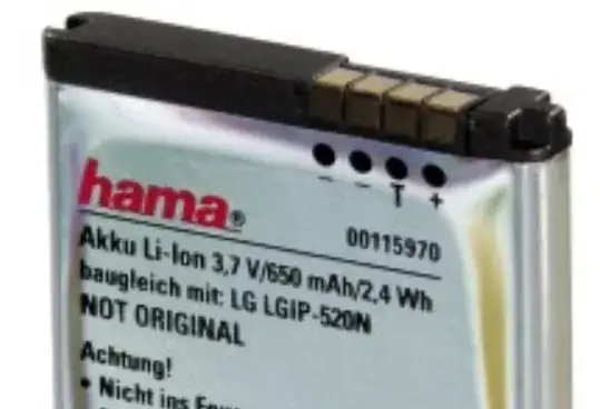

I think two of the pins are (-) for the battery + protection circuit, one is for the (+) of the battery + protection circuit, and the fourth is for a 10K thermistor to the (-) side. See this compatible battery image. T = Thermistor.
