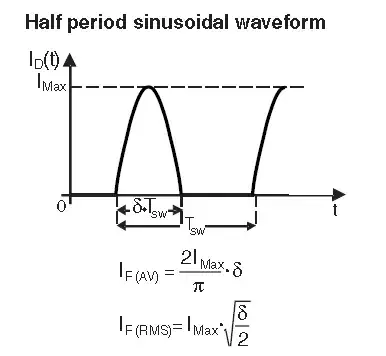

Assuming sinusoide waveform:
Diode drop voltage shorten the duty cycle δ. Diode drop voltage depends on Iavg (see diode datasheet Iavg vs Vf curve)
