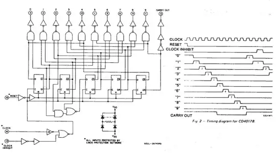

    I thought a Johnson counter was a shift register whose last stage loops to the first, and which contains an odd number of inversions [typically, though not necessarily, one]. They are often used in the implementation of one-hot counters [if each register has true and complement outputs, one can get one-hot outputs from a Johnson counter using a two-input gate for each output]. – supercat Jul 22 '14 at 22:18
If you are making a decimal counter and decoding it, a Johnson counter uses 5 rather than four flip-flops, but can be decoded to 10 outputs with only 2-input gates for a net saving in CMOS technology.
Below is an example from the CD4017 datasheet.
