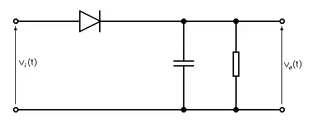

For a better detection of the modulated signal with the diode detector below, one requirement is that the time constant of the RC filter conforms to:
$$ \frac{1}{\omega_{c}} \leq RC \leq \frac{ \sqrt{1-\mu^{2}}}{\omega_{m}\mu} $$
where:
  • \$\omega_c\$ is the angular frequency of the carrier
  • \$\omega_m\$ is the angular frequency of the information, and
  • \$\mu\$ is the modulation index.
How exactly can we prove that?

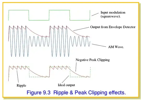

Here is a picture that hopefully explains: -
This picture was taken from here and basically is saying, if the modulation index is too high for the value of RC chosen there will come a point in the detection of the signal that the RC time constant is too long.
You should also note that as the modulation index approaches 1, the RC time constant has to theoretically be very small and this will make it likely clash with the requirement for it to be significantly greater than \$\dfrac{1}{\omega_c}\$.

Now the second inequality is required to get rid of negative peak clipping.
Here if we assume our envelope to have to equation $$ V(t) = V_p(1+\mu\cos\omega_mt)$$ where \$V_p\$ is the peak value or amplitude of modulated input wave, then between two peaks the signal will be falling at the rate \$\dfrac{dV}{dt} = -\mu V_p \omega_m \sin\omega_m t\$ whose maximum value is (in magnitude) \$\mu V_p \omega_m\$. Thus the "slope" of the plot of the wave (voltage) versus time has a maximum value \$\mu V_p \omega_m\$.
Now the output supplied by the diode detector between two peaks is given by $$V(t)=V_p e^{-\frac t {RC}}$$ Thus between two peaks the output falls at the rate \$-\dfrac{V_p}{RC}e^{-\frac t {RC}}\$ which is roughly (in magnitude) \$\dfrac{V_p}{RC}\$, as \$e^{-\frac t {RC}} \approx 1\$. This is because the maximum value of \$t\$ between two peaks is going to be \$\dfrac{2\pi}{\omega_c}\$, which is very much smaller than \$RC\$ as we have already seen above. This means \$\dfrac t {RC}\approx 0\$, so \$e^{-\frac t {RC}} \approx 1\$.
Now to avoid negative clipping, it is clear from the above picture that the magnitude of the slope of the output waveform must be greater than the magnitude of the slope of the input waveform, i.e the rate at which the input falls. Since this must always be the case, we need the slope of output waveform to be greater than the maximum value of slope of input waveform.
Thus we must have $$\mu V_p \omega_m \le \dfrac{V_p}{RC}$$ This simplifies to \$ RC\le \dfrac{1}{\omega_m\mu}\$.
