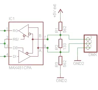

A typical schema using MAX481 for a DMX controller is:

So you need at least one driver chip and to be safe you better make an isolation with some optocouplers. A minimal solution with only:
  • 1x SN 75176
  • 1x 100 Ohm 1%
but there is no isolation!
SN75176 Arduino DMX circuit

    "*A typical schema using MAX481 for a DMX controller is:*"... the non-inverting in/output A should be connected to the positive bias, the inverting in/output should be connected to the negative or ground bias. – Erik84750 Jun 03 '17 at 19:50
