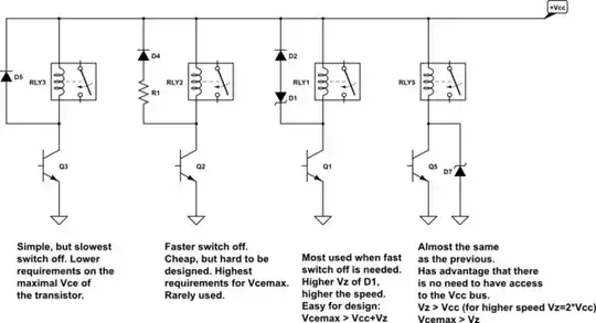

There is simple answer to this question - there are many flyback schematics and the reverse diode is the simplest one. Although it has one big disadvantage - it makes the relay to switch off very slow.
This way, sometimes other schematics are to be used. There are several examples:

  • isn't the design for #2 just Ohm's law? Why is that hard to design? – markrages Feb 19 '14 at 15:38
  • @markrages It would be "just Ohm's law" if D4 was shorted. – Alex Shroyer Feb 19 '14 at 15:51
  • e.g., 100 mA relay, Vcc=12V, 0.7 Vf on D4, Q2 60 Vceo. Say we want 40 V max on Q2. Then max voltage on R is (40 - 12 - 0.7) or 27.3. R = V/I so 27.3 / 100 mA or 270 ohms. – markrages Feb 19 '14 at 15:54
    @markrages - the problem with the second schematic is that the current through the relay is never known. The resistance of the relay is very sensitive to the temperature and the current may vary significantly. Then you need to design for the worst case. In all other schematics, the voltage is relatively constant and depends only on the zener voltage. – johnfound Feb 19 '14 at 16:48
  • At DC, the current is only limited by the resistance of the coil. This is spec'd to 10%, and then there is copper's tempco of about 0.4%/C. Since this is positive, it is fine to design with the room-temperature (spec) current. – markrages Feb 19 '14 at 17:14
  • @markrages Everyone designs his own devices in a way he likes. – johnfound Feb 19 '14 at 18:20
